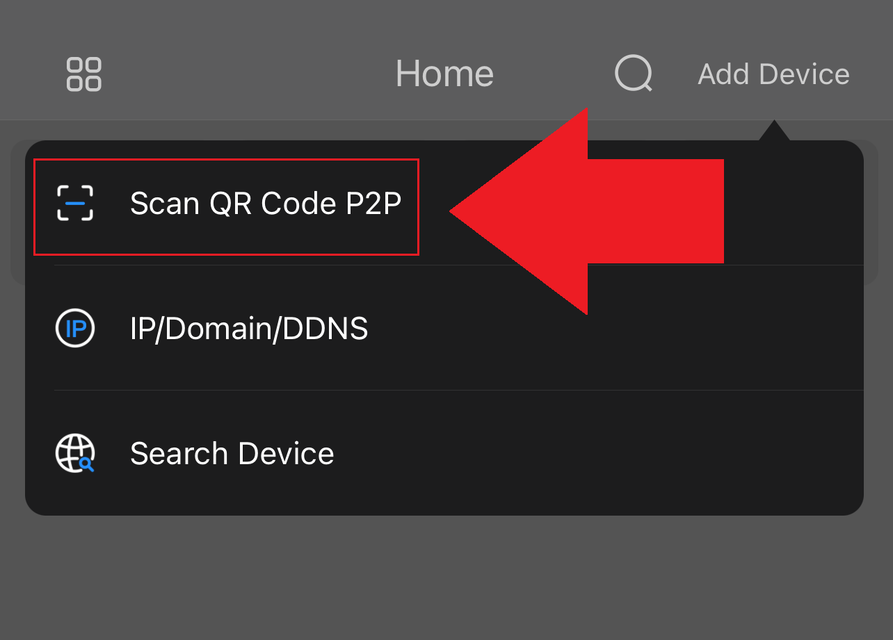

Step 1: Open the Amcrest View Pro 2 app, tap Add Device, and select Scan QR Code P2P.

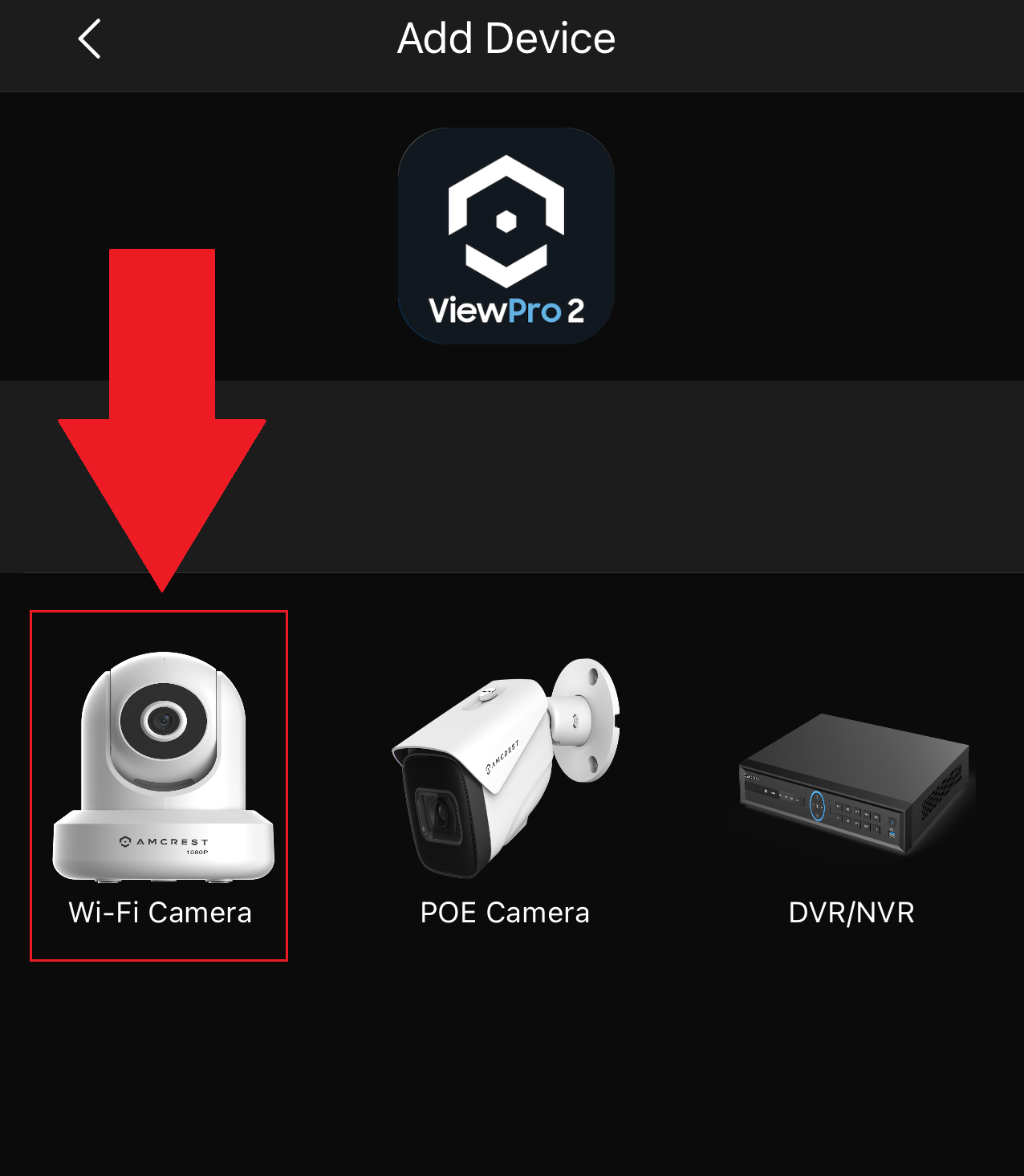

Step 2: Scan the QR code found on your device or enter the S/N in manually if needed and select your device type. Step 3:

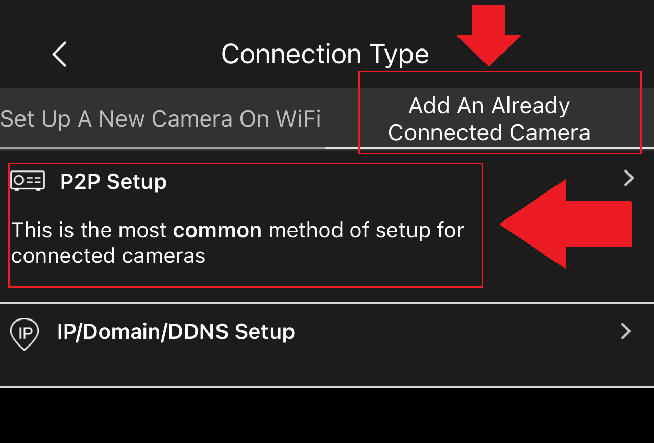

Step 3: Tap Add An Already Connected Camera and select P2P Setup.

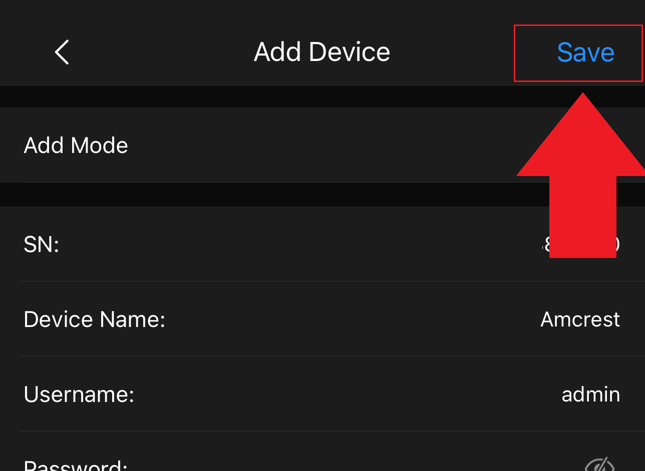

Step 4: Enter a name for your device as well as the device password and tap Save.
