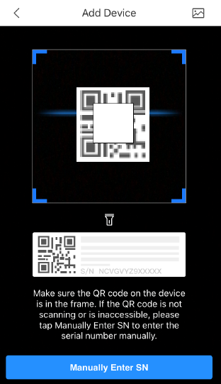

Step 1: Open the app and tap Add Device. Select Scan QR Code P2P.
Step 2: Scan the QR code from the camera or manually enter the device's serial number into the Enter camera S/N (serial number) field.

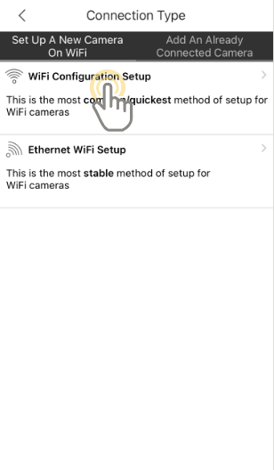

Step 3: Tap WiFi Camera.
Step 4: Tap WiFi Configuration Setup.

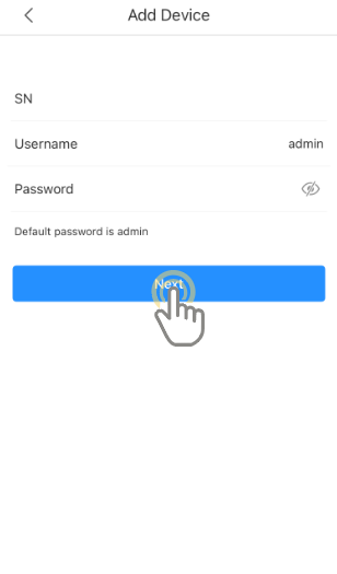

Step 5: If using a camera that requires connecting to a hotspot, allow all permissions. If using an Android, tap Connect to Hotspot and connect to the SSID manually. Enter admin into the Password field, Tap Next.

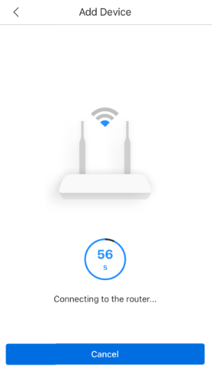

Step 6: Select your WiFi network. Enter the password for your WiFi network and tap Next. Allow the camera to connect to the network.

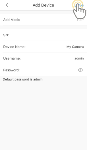

Step 7: Enter a name for the device in the Device Name field. Enter the default password for the camera in the Password field. The default password will be admin. Tap Save.

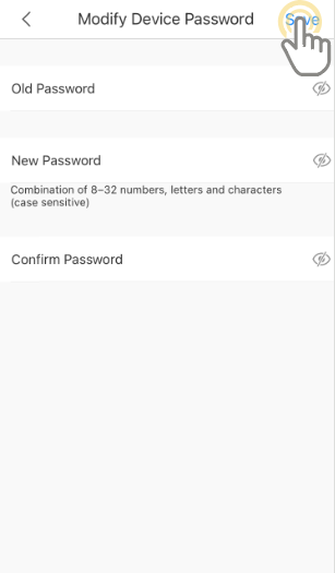

Step 8: Enter the default password into the Old Password field, enter a new password for the camera into the New Password field and confirm. Tap Save to add the camera to the app.
