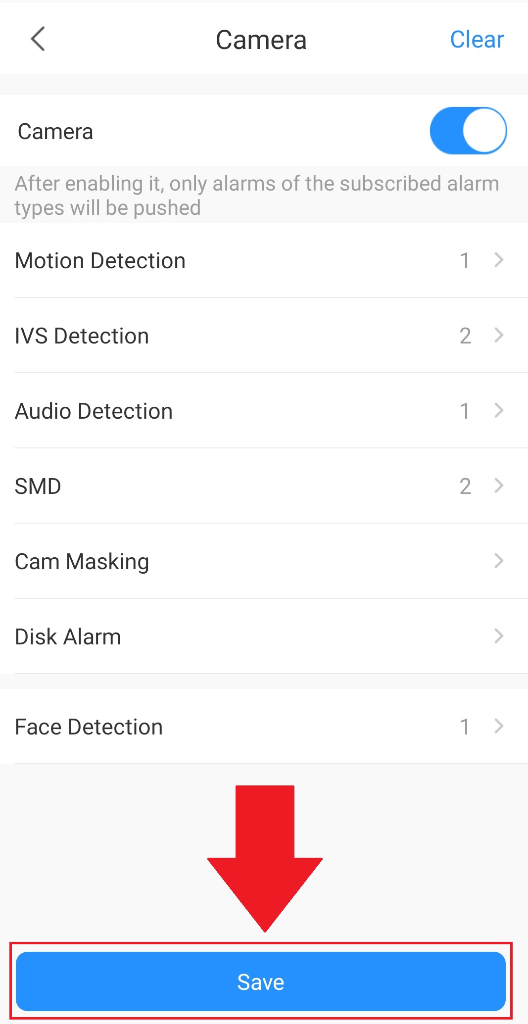

Step 1: Open the Amcrest View Pro 2 app and select your device, and access the Device Details. Tap Push Notifications.
Note: Push notifications can also be accessed in the alarm settings portion of the device settings menu.
Step 2: Tap Enable and select which push types will be applicable to your specific camera. A schedule can be set for push notifications, however, will be set to trigger 24/7. Tap Save.
Note: Push types include, motion detection, IVS (tripwire, intrusion, abandoned object, human and vehicle detection, etc.)

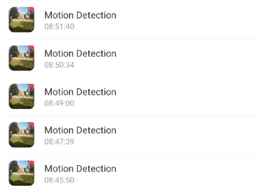

Step 3: Select the Events tab on the main menu to access push events. Please note, as a reminder, iOS users may need to select the event using the pop up notification to populate the event notification and thumbnail into the Event menu.
