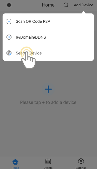

Step 1: Tap Add Device and select Search Device.

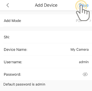

Step 2: Select the device and select P2P from the Add Mode menu. Give the device a name and enter the device's password into the Password field. Tap Save to add the device into the app.
