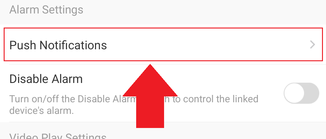

Step 2: Tap Push Notifications.
Note: Push notifications can also be accessed in the alarm settings portion of the device settings menu.

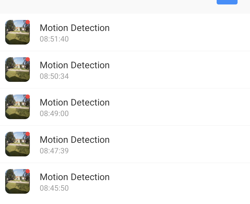

Step 4: Access the Events menu to access push events captured by the device for each channel selected.
