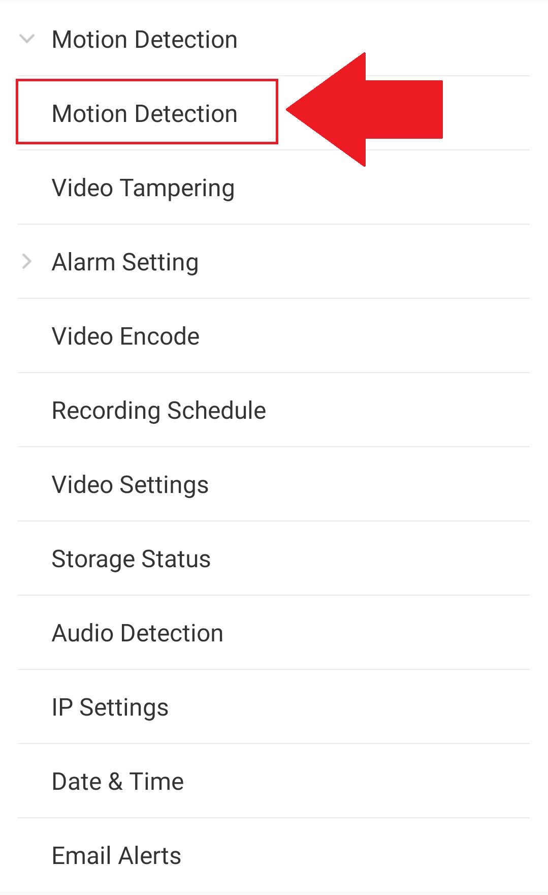

Step 1: Open the Amcrest View Pro 2 app and select your device, tap on the settings (gear wheel), access the Configuration Center, tap Motion Detection, and select Motion Detection.
Step 2: Ensure the Enable and Advanced Configuration options are enabled and modify any settings if needed. The settings are as follows:

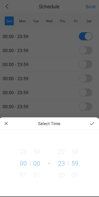

Schedule: To set a schedule, select a day and a period, then use the time range provided to set the schedule. Tap the checkmark and tap Save to apply the schedule to your device.
