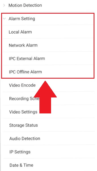

Step 1: Open the Amcrest View Pro 2 app and select your device, tap on the settings (gear wheel), access the Configuration Center and select Alarm Setting.
Step 2: Choose an alarm setting. Select either a local, network, or external alarm if applicable.
