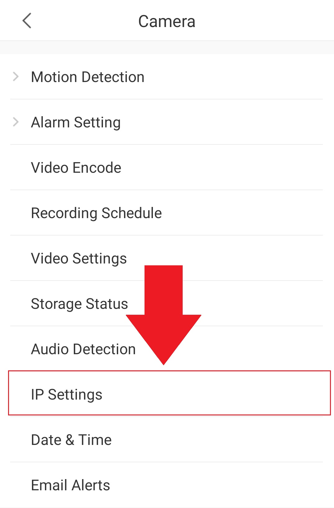

Step 1: Open the Amcrest View Pro 2 app and select your device, tap on the settings (gear wheel), access the Configuration Center and select IP Settings.

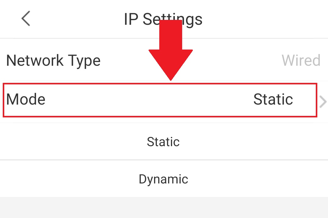

Step 2: Tap Mode to select between a Dynamic or Static IP.
