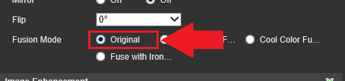

Step 3: Make sure the Fusion Mode option is set to Original.

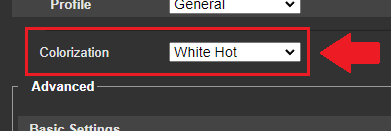

Step 4: Ensure the White Hot option is selected in the Colorization menu.

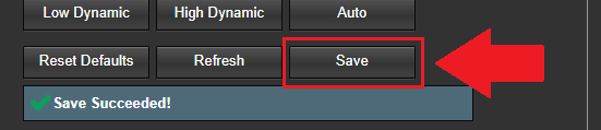

Step 5: Click Save to save the color palette settings.
