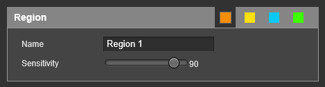

Step 3: If multiple detection regions need to be applied, use the color-coded options in the region section, then use your mouse to apply them to the screen.

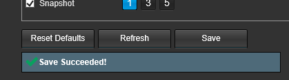

Step 4: Select any additional options such as send email, siren, or warning light that will be activated once the rule has been triggered. Click Save to apply the rule.
