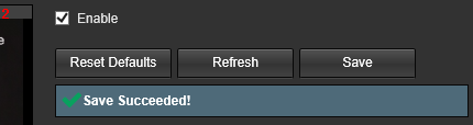

Step 2: Click Setup>>Smart Thermal>>Picture-In-Picture. Click Enable and click Save.
Step 3: The thermal image channel will be displayed in the visual channel.
