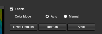

Step 2: The thermal information is colored automatically or manually in the interface.

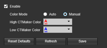

Step 3: To color code it manually, click the Manual button located in the Color Mode field.
Use the high CTmaker color or low CTmaker color options to set a color palette for the high and low temperatures detected in the thermal channel.
