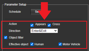

Step 3: Click on the IVS option in the Event menu then click on the ( + ) icon to add the rule. Select Intrusion from the Rule Type menu.  Use your mouse on the intrusion box and set a detection area.
Step 4: In the Direction menu, choose how the rule will be triggered if the object enters only, exits only, or enters & exits a set region. An optional object filter can be set that will allow the rule only to be triggered if it detects an effective object such as a human or vehicle. You can choose both filters if needed.
Step 5: Enable the Record Channel option as well as any other options you would like to set for this option and click Save to save and apply the settings.
