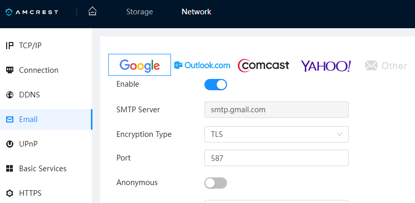

Step 2: In the Network menu select Email and select your email provider, which in this case will be Gmail.
The preferred SMTP information will be imported into the interface, which is TLS (port 587), however, you can select SSL (port 465) as well if needed.

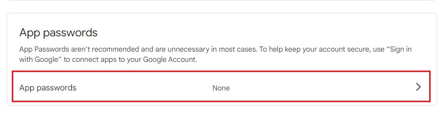

• Click on ensure 2-step verification is enabled. In the 2-step verification menu, scroll down and locate App passwords

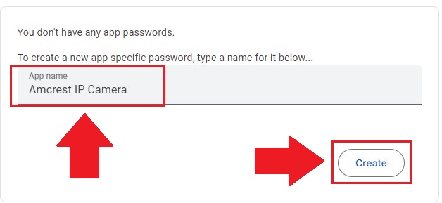

Screenshot 2024-10-16 154916.jpg• Enter a name for the authentication and click Create.

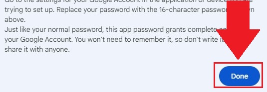

• Google will generate an app password which must be entered into your Amcrest device's Email Setup interface in the web UI.
