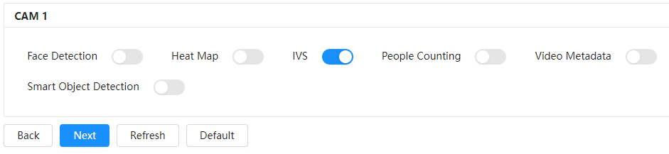

Step 3: Click Next. Select IVS from the Smart Plan menu and click Next.

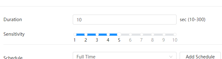

Step 4: Click Add Rule and select Crowd Gathering from the dropdown menu. Use your mouse to draw a detection area on the interface. The default duration in which the objects can remain in the area will be 10 seconds, however, can range up to 300 seconds if needed.
