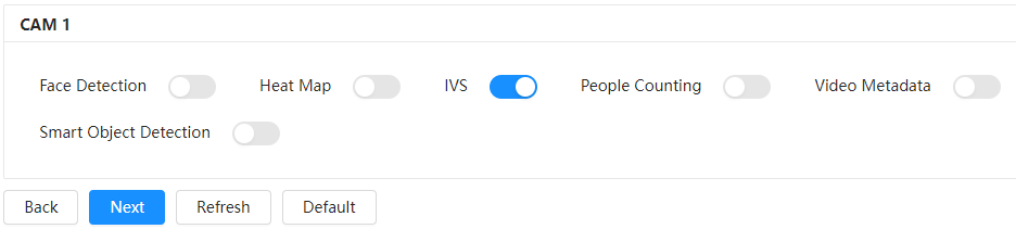

Step 2: Access the main menu and click on AI. Select a General or Schedule plan, if you would like more information on how different intelligence modes work on your camera, click here.
Step 3: Click Next. Select IVS from the Smart Plan menu and click Next.

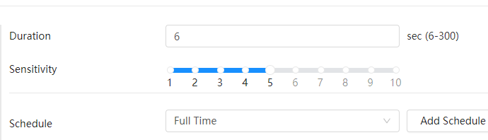

Step 4: Click Add Rule and select Parking Detection from the dropdown menu. Use your mouse to draw a detection area on the interface. The default duration in which the object can stay in the detection area is 6 seconds, however, can range up to 300 seconds if needed.
Step 5: Click Record to retain events to a microSD card. This will allow you to view IVS events in the playback menu. Select any additional options, such as a siren, which will allow the camera to produce an audible siren, or email to send a notification of the event to an entered email address. For more information on how to setup email alerts, click here. Click Apply when finished.
