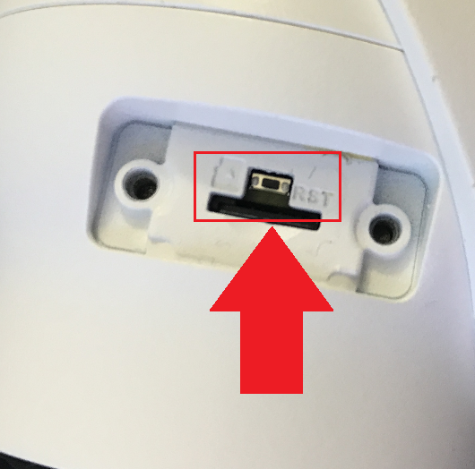

Step 1: Locate the reset hatch on the camera and remove the cover.
Step 2: Press and hold the Reset button for 30 - 45 seconds allowing the camera to reset.
Step 3: Once the reset of the camera is complete, place the reset hatch back onto the camera and secure it back onto the camera.
