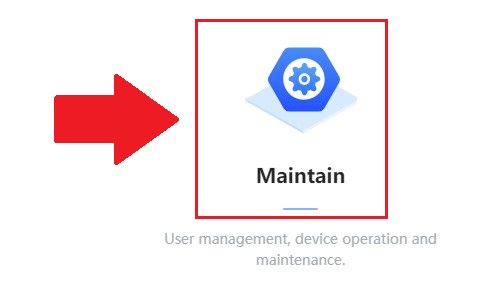

Step 2: Click on the Maintain option on the main menu.

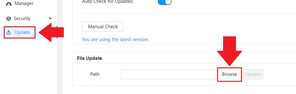

Step 3: Click on Update and select Browse.

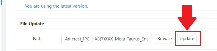

Update.jpgNote: Select the firmware file for your camera and import it into the interface.

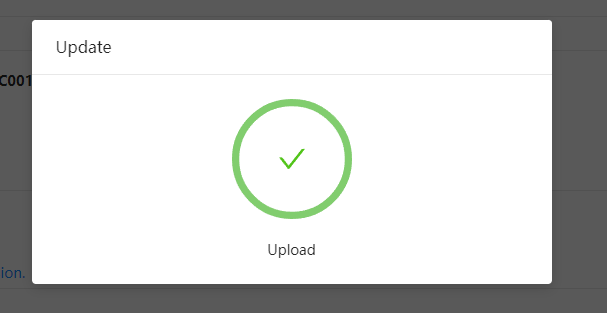

Step 4: Once the firmware is imported, click Update.
Step 5: Allow the device to update. Do not unplug or disconnect your device while updating.
The device will restart automatically after the update. Allow the device to reboot after upgrading to access it again in the web browser.
