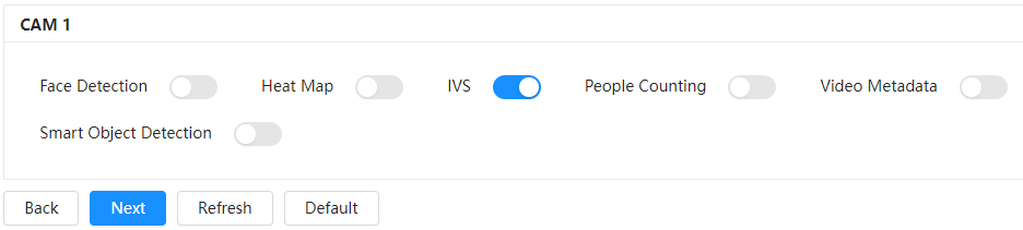

Step 3: Click Next. Select IVS from the Smart Plan menu and click Next.

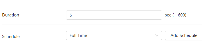

Step 4: Click Add Rule and select Loitering Detection from the dropdown menu. Use your mouse to draw a detection area on the interface. The default duration in which the objects can remain in the area will be 5 seconds, however, can range up to 600 seconds if needed.
