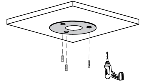

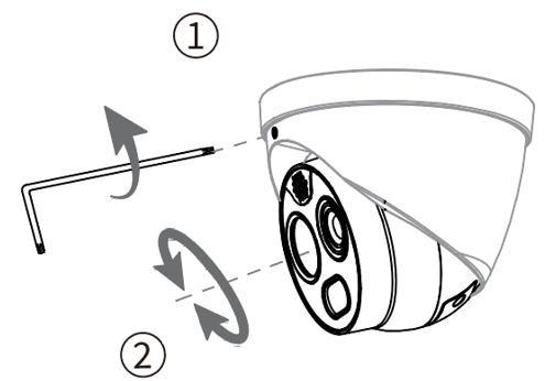

| 1. Apply the installation sticker to the mounting surface. Use a drill head to drill the holes on the sticker and insert the wall anchors. Please note, a 1” paddle bit can be used to run any cabling through the surface. | 2. Use the included torx wrench to remove the camera from the installation bracket. |

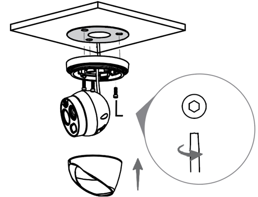

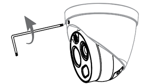

| 3. Align the holes of the installation bracket to the holes provided on the installation sticker and wall anchors. Connect any wiring, apply the installation bracket to the surface and secure using the provided installation screws. Place the turret cover over the camera. | 4. Adjust the camera to a desired position and use the torx wrench to secure the camera to the installation bracket. |
