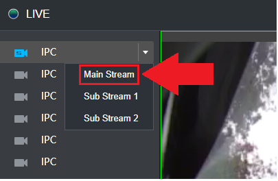

Note: If using Google Chrome or other mainstream web browsers the sub-stream for the device may be displayed in the interface by default. Please note, some older computers may not be able to support H.265 compression which may result in a corrupted file. To change the live view to the mainstream, click on the stream selection dropdown menu and select Main Stream.

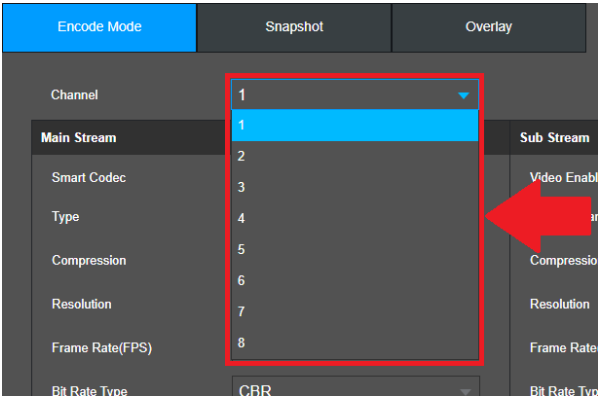

Step 2: In the Management section, click on Camera and access the Encode menu. In the Encode menu, choose a connected device from the Channel list.

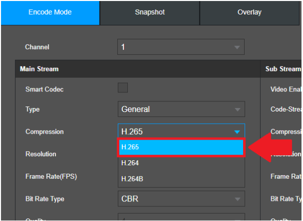

Step 3: Locate the Compression dropdown menu and select H.265.
Step 4: Click Save to save your settings.

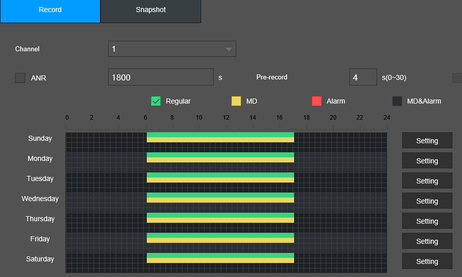

Step 1: Log in to the web UI for your device and click on Management and select Storage.

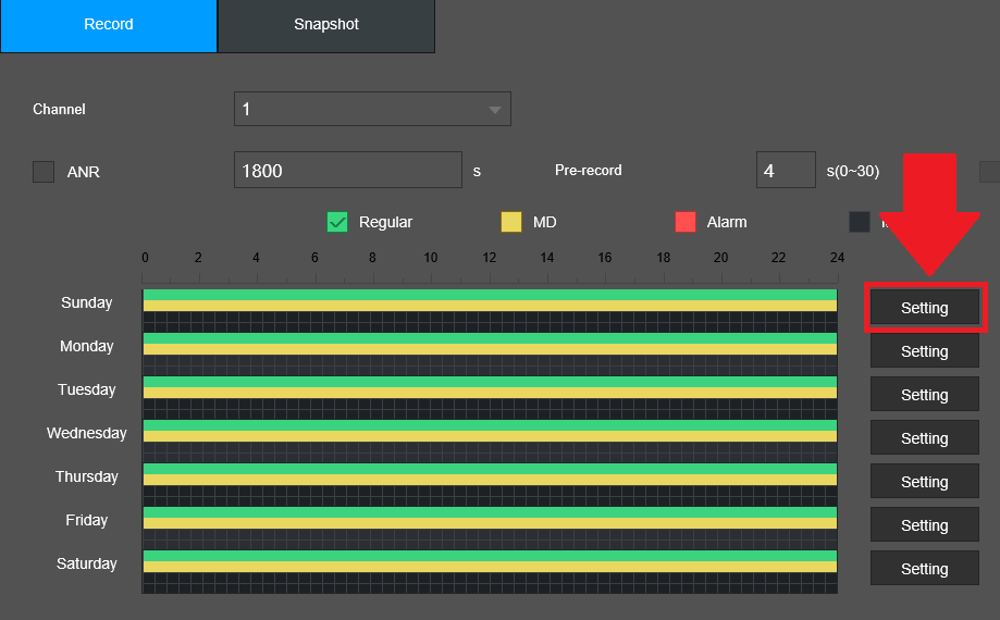

Step 2: In the Record tab you will notice a series of days on the left of the schedule and the number of hours at the top (specified in increments of 2 hours). You will also notice 4 checkboxes representing each recording type. Please note, if using an AI NVR, a fifth recording type (IVS) may be preset. Click Setting to begin customizing a recording schedule.

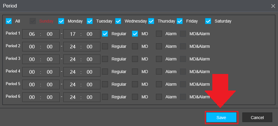

Step 3: Select which day of the week you would like the recording schedule to apply. If you would like the schedule to apply to all days of the week, click All. Select which recording type you would like to use, which in this case, we will select general, and motion. Set a time of day in which the type will be applied. For example, in this case the recording schedule is set to be active from 0600 (6 am) - 1700 (5 pm)
Note: The timeframes will be formatted to military time.
Please note, a total of 6 separate periods can be set up at a time which will provide different recording schedules to be active for different days of the week.
Step 4: Click Save to save and apply the recording schedule
The recording schedule will now be set to record only on the specified dates and times chosen.
