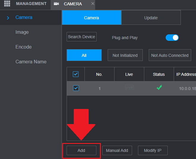

Step 2: Click on Management and select Camera.
Step 3: Click Device Search and select your devices from the device list. The device will have a default ONVIF protocol in the interface, click Add.

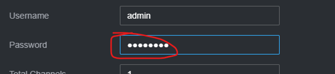

Step 4: If the camera is set to default, the password will be admin and will register as online (green), however, if the camera is red, the password may need to be entered manually. To modify the device password, click the pencil icon under Edit. Enter the camera's password and click OK.
