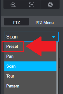

Step 2: Open the live view menu, select your PTZ camera, and open the PTZ control menu. This is where you will set your tour presets. Open the PTZ dropdown menu and select Preset.

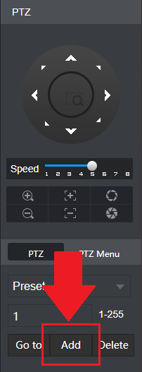

Step 3: Use the PTZ directional options to set your presets. To set a preset, use the provided pan, tilt, and zoom options, name the preset and click Add.
Continue adding presets making sure to number each preset as you go.

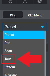

Step 4: Once all presets have been made open the PTZ dropdown menu and select Tour.
