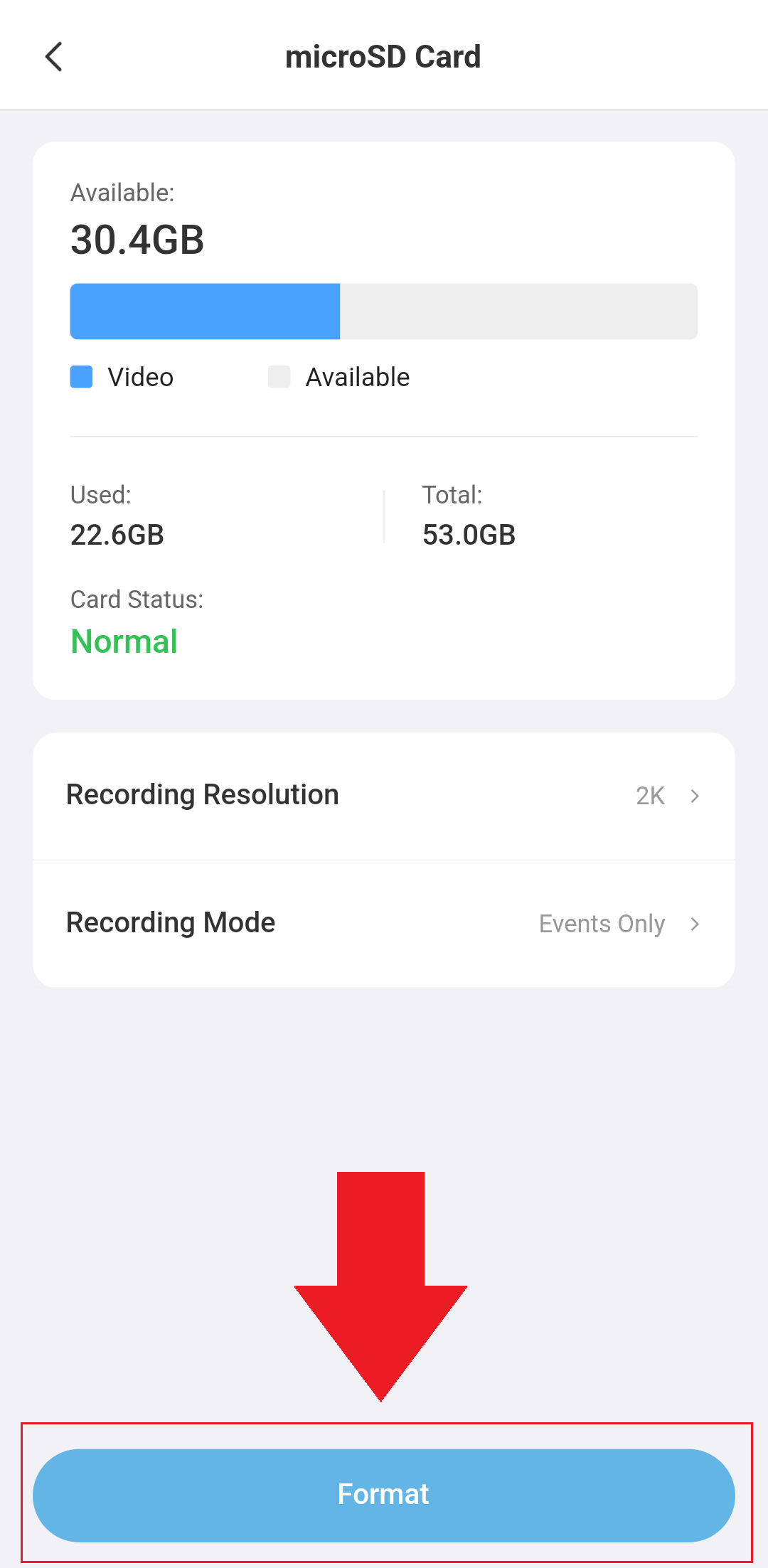

A microSD card can be formatted using the Amcrest Link app. This will clear all data on the microSD card and format the microSD card to FAT32. Formatting the microSD card is performed using the microSD card menu under device settings. For more information on how to format the microSD card, please refer to the information provided below.
Note: The camera can support up to 128GB, however, if your microSD card is not being detected it may need to be externally formatted to FAT32, for more information on how to externally format a microSD card, click here.
Step 1: Open the app, locate the device and tap Settings.
Step 2: Tap the microSD card option.
Step 3: Tap Format.
