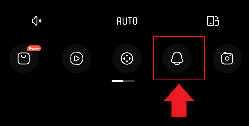

The Message menu allows you to view and display device specific events in a list, this includes motion detection and human detection events stored on a microSD card or stored in the cloud. To access this menu, open the Amcrest Link app, access your device from the home menu, and select the bell icon on the bottom banner.
A list of events captured by the camera will be displayed, use the microSD card icon to access events from a microSD card, tap the cloud icon to access events stored on the cloud.
