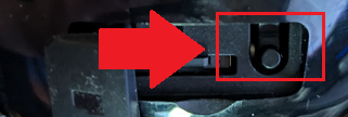

Step 1: Locate raise the rubber "Reset" cover on the PT camera and locate the reset button.

Step 2: Press and hold the factory reset button for 5 - 15 seconds allowing the camera to reset. Once the reset is complete, the status LED on the camera will flash blue indicating it is ready to add back into the app.
