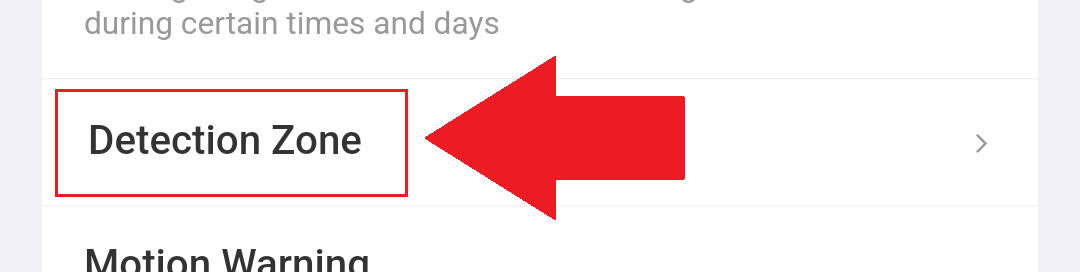

Step 2: Open the Motion/Human Detection menu and tap Detection Zone.

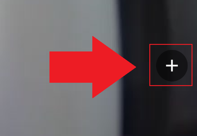

Step 3: Tap Draw Detection Zone and tap the "+" icon to add a detection zone.

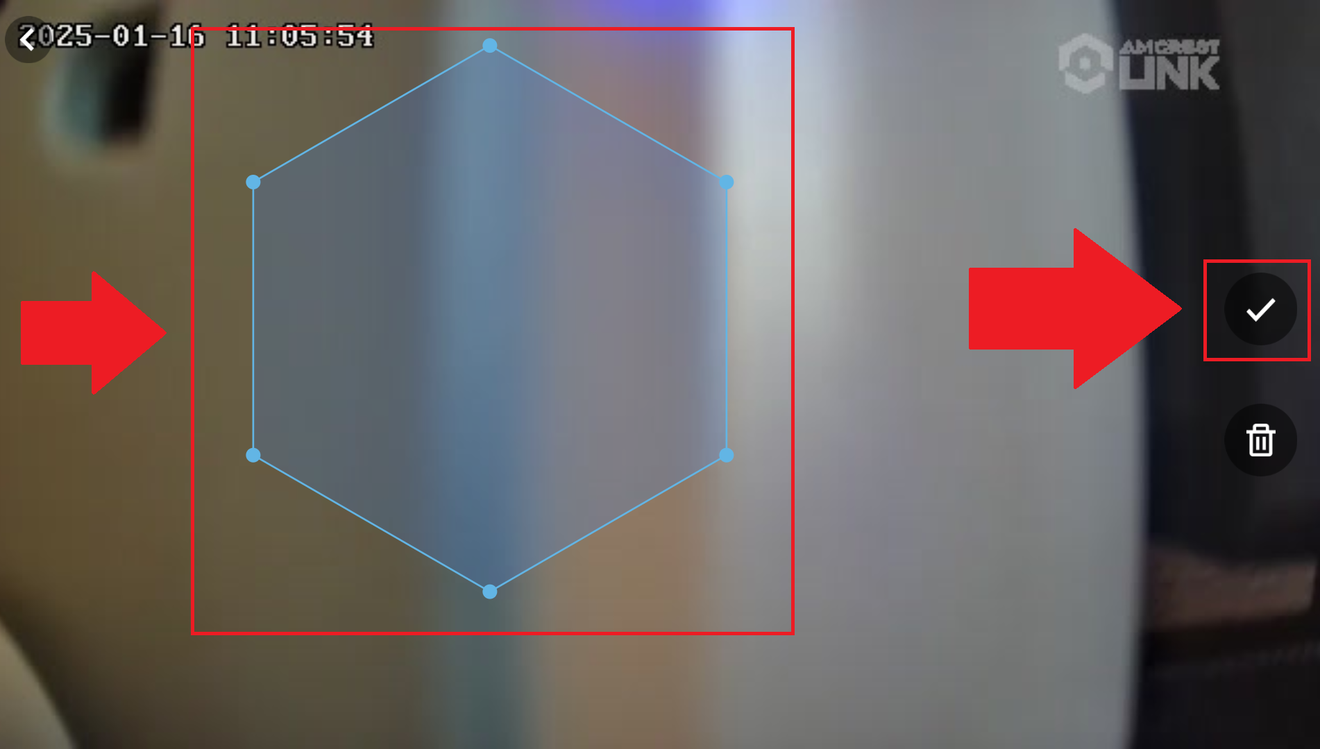

Step 4: Use your finger on the provided overlay to modify the detection zone. Tap the checkmark to set the detection zone.
Note: To modify the zone, tap the ( ) icon. To exit the interface, tap the "<" icon. This only applies to fixed lens detection, detection by the PT lens will be full screen.
