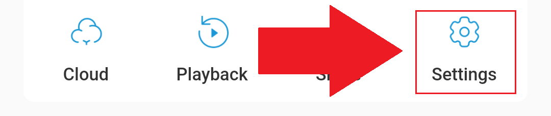

Step 1: Access the push notification menu for your device. To access this menu, locate your device on the home menu and tap Settings.

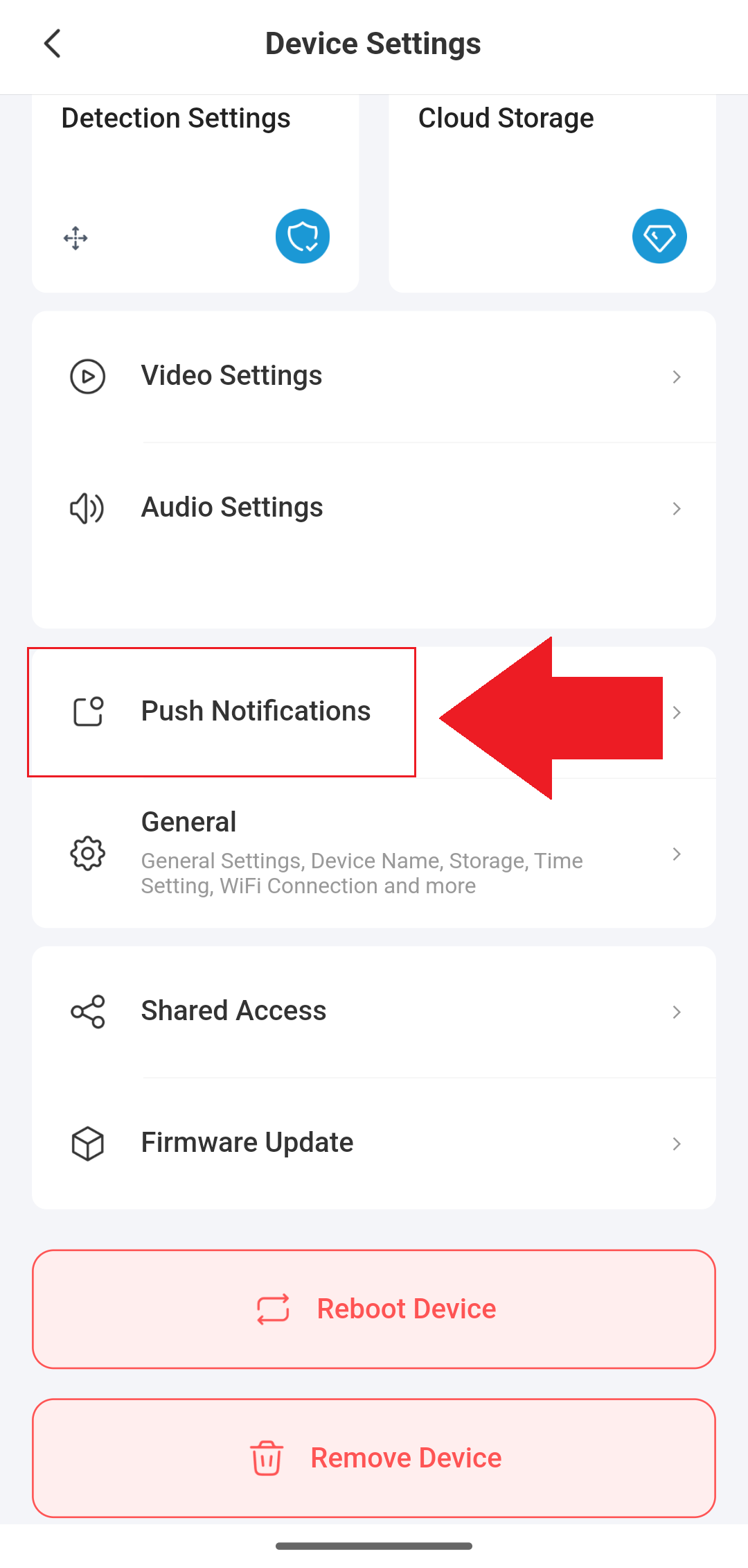

Step 2: Scroll down and select Push Notifications.

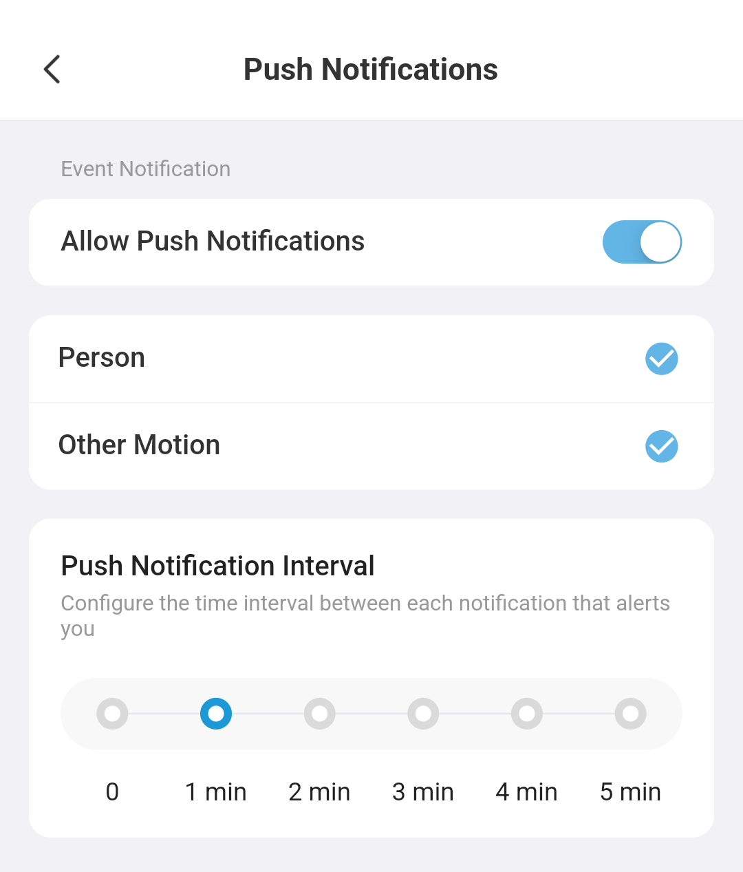

Step 3: Tap the Allow Push Notifications option to enable or disable push notifications.
To allow only human detection push notifications, disable the "other motion" option. To allow only basic motion detection events, disable the "Person" option. The Push Notification Interval option allows you to set the time interval in between each push notification. The default will be 1 minute, however it can be set between 0 and 5 minutes if needed.
