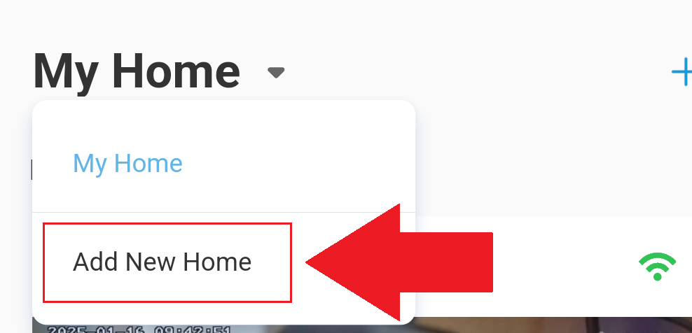

The My Home option allows the user to organize and group cameras into separate locations (homes) or rooms if multiple cameras on the account are in different locations. "My Home" is the default location, cameras can be assigned to multiple rooms within the default location, however, if cameras are applied to a new home, tap the My Home option and select Add New Home.
The home management feature allows you to customize the name of your home, add new home locations, as well as customize, move, and label cameras into different areas. Cameras that are from shared users cannot be grouped with cameras on your main account. For more details, please refer to the information provided below.

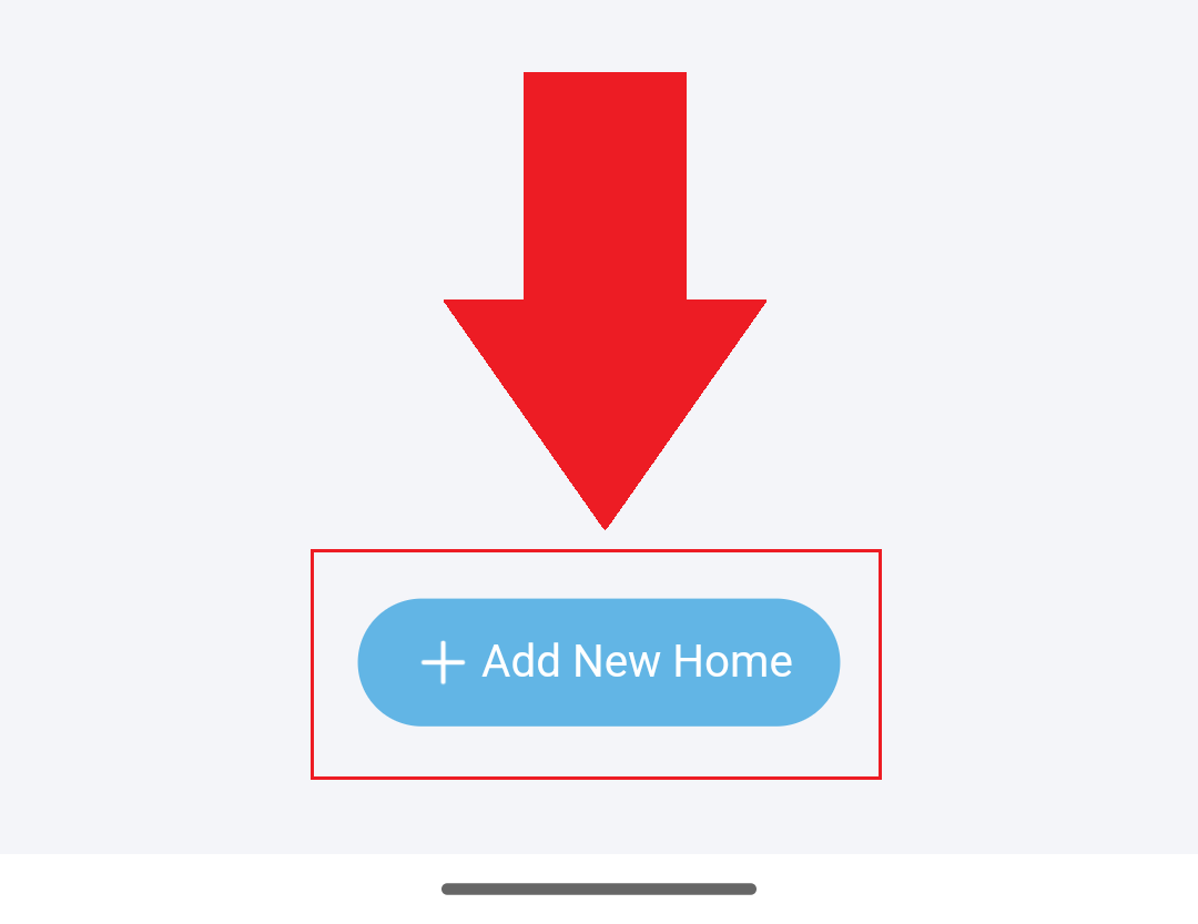

If the camera is in another location, such as another home or property, a new home entry can be made within the app to organize and group your cameras. To begin creating a new home, tap the + Add New Home.

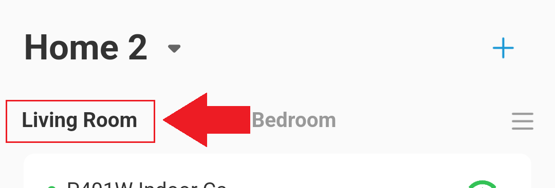

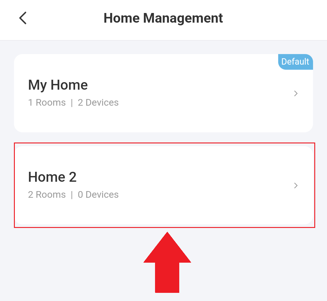

Enter a name for the home and click OK, a new home field will be added into the home management interface. The cameras can then be assigned and moved to multiple rooms if needed. Tap the new home field.

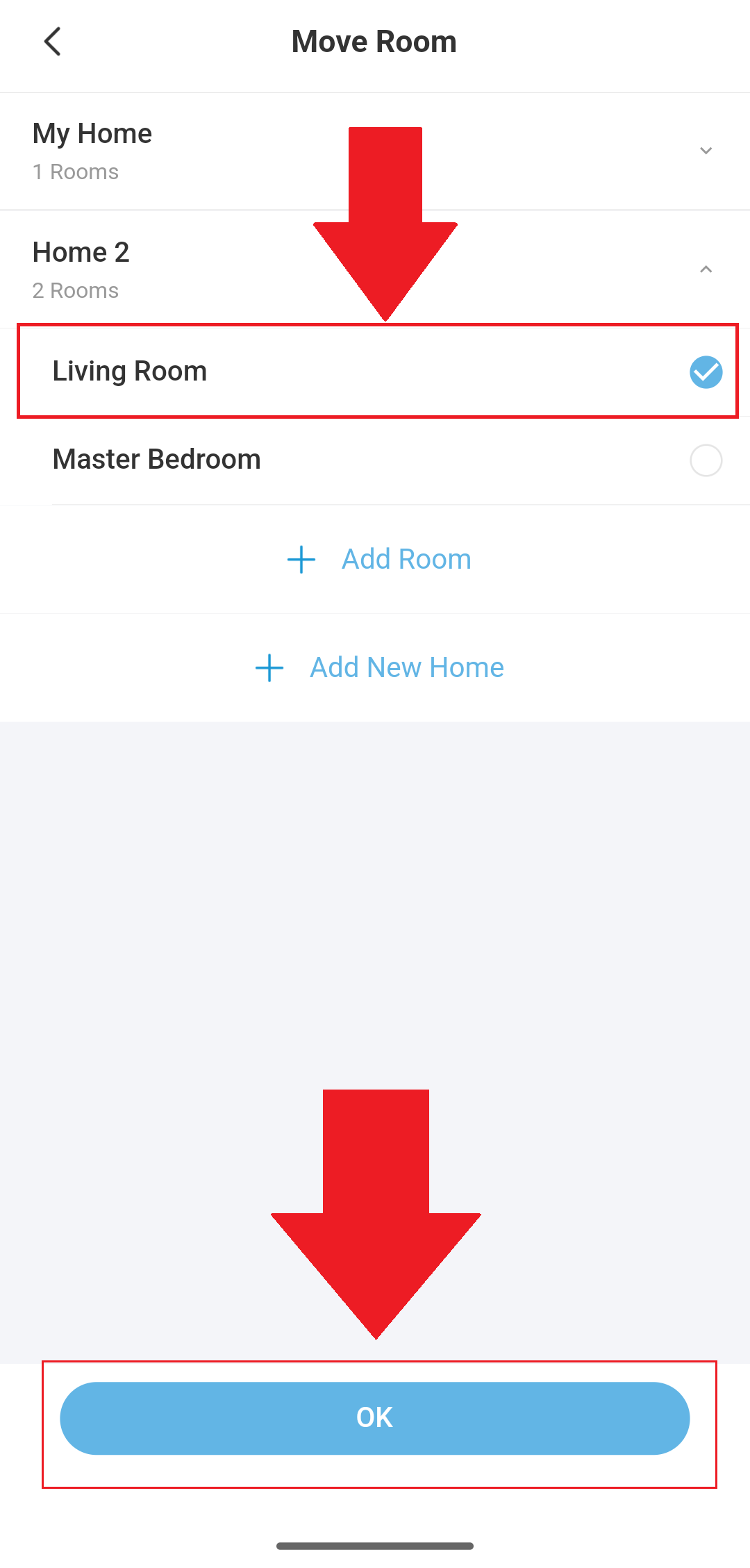

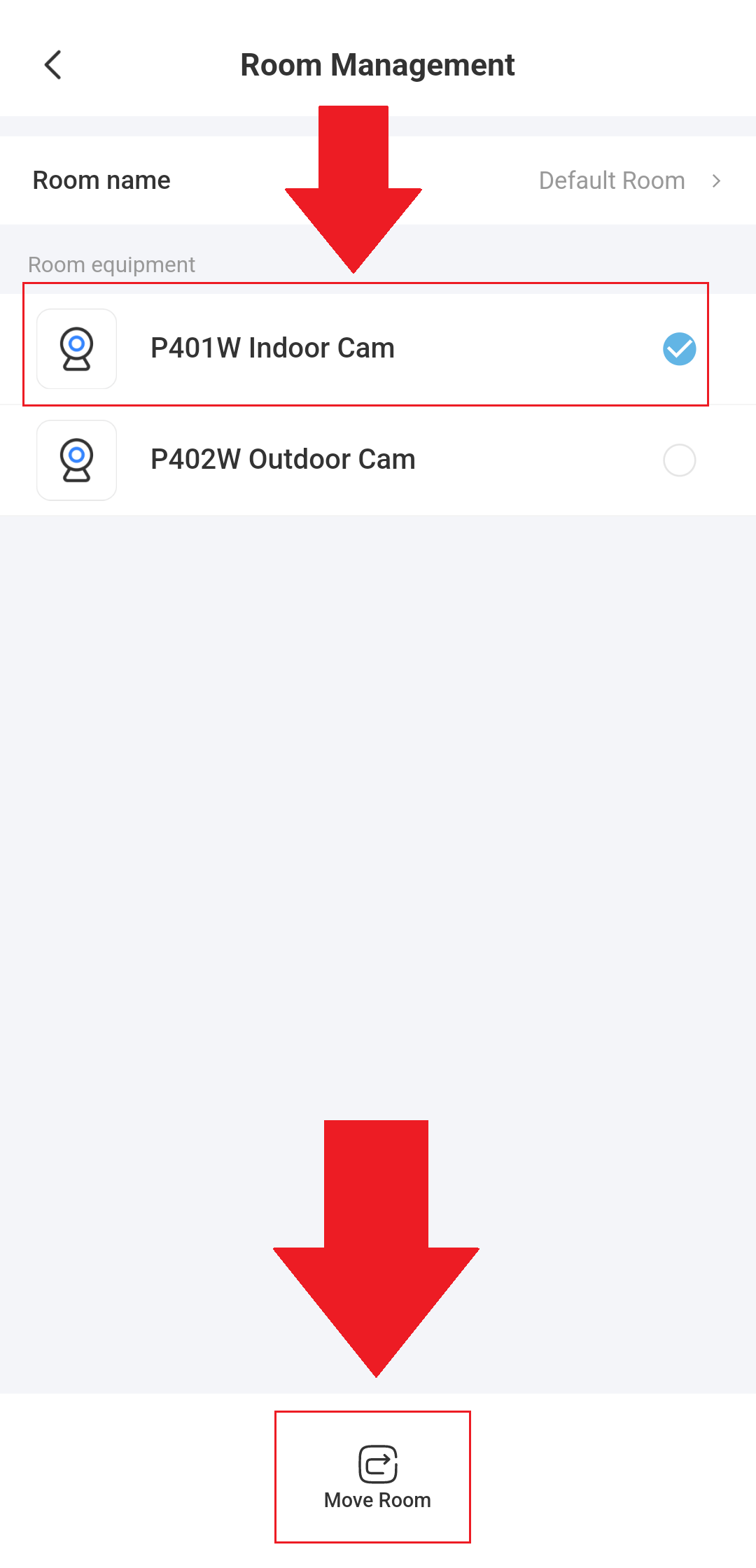

To assign a device to a room, tap + Add Room to create a room, name the room locations within the new home and tap OK. Return to the home management interface and select the default home which has the connected devices. Select the device you want to move and tap tap Move Room.
Select which room you would like to move the device to and click OK.
Open the new home location and ensure the device has been moved to the correct location.
