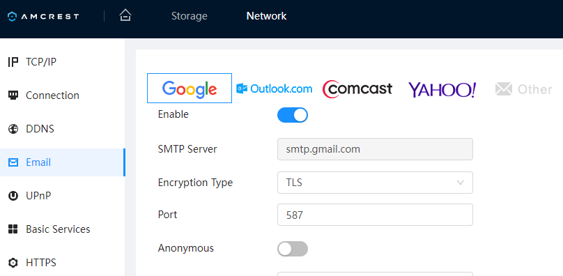

Step 1: Click on the Settings icon and select Network.
Step 2: In the Network menu select Email and select your email provider, which in this case will be Gmail.
The preferred SMTP information will be imported into the interface, which is TLS (port 587), however, you can select SSL (port 465) as well if needed.

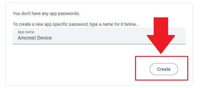

Enter the email address you will be using in the Username field as well as the Google generated password in the Password field. To generate an app password, access your Gmail account, and click on Manage Your Google Account.
Make sure 2-step Verification is enabled, and in the search bar enter App Passwords. Enter a name for the app and click Create.
Note: Notate the generated password provided by Google. This will be the password used to set up email notifications in your device.
