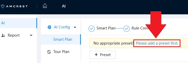

Crowd Gathering is used to detect a group of people that enter or exit a specific area set by the user on the live view screen. A preset must be established before adding a IVS rule. For more information on how to setup the rule please refer to the information provided below.

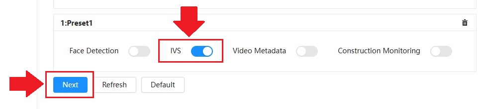

Step 4: Click + Preset and add the preset into the interface. Select the IVS option and click Next.

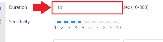

By default the rule will be set to trigger if multiple people are within the detection area for a duration of 10 seconds. However, you can adjust the duration if needed from 6 - 300 seconds. Use the sensitivity slider to adjust the amount of people detected before the rule is triggered. The higher the sensitivity the less people are needed in the area before it is triggered.

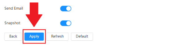

Step 7: Click Record to retain events to a microSD card. This will allow you to view IVS events in the playback menu. Select any additional options, such as a siren, which will allow the camera to produce an audible siren, or email to send a notification of the event to an entered email address. For more information on how to setup email alerts, click here. Click Apply when finished.
