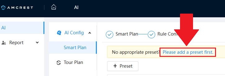

Loitering Detection is used to detect if a person or group are loitering in a specific area set by the user. A preset must be established before adding a IVS rule. For more information on how to setup the rule please refer to the information provided below.

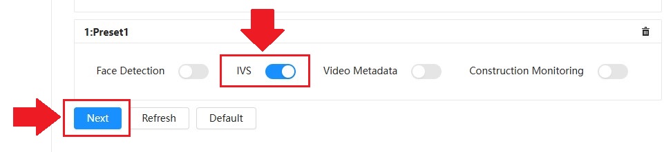

Step 4: Click + Preset and add the preset into the interface. Select the IVS option and click Next.

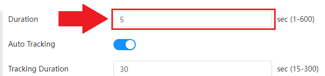

By default the rule will be set to trigger if multiple people are within the detection area for a duration of 5 seconds. However, you can adjust the duration if needed from 1-600 seconds.

Note: This camera also supports Auto Tracking. This will allow the camera to automatically track the object until it is no longer visible in the detection area. There is also a Auto Patrol feature, which allows you to set preset points to patrol a area, for more information on the auto patrol feature, click here.

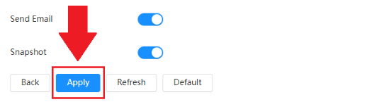

Step 7: Click Record to retain events to a microSD card. This will allow you to view IVS events in the playback menu. Select any additional options, such as a siren, which will allow the camera to produce an audible siren, or email to send a notification of the event to an entered email address. For more information on how to setup email alerts, click here. Click Apply when finished.
