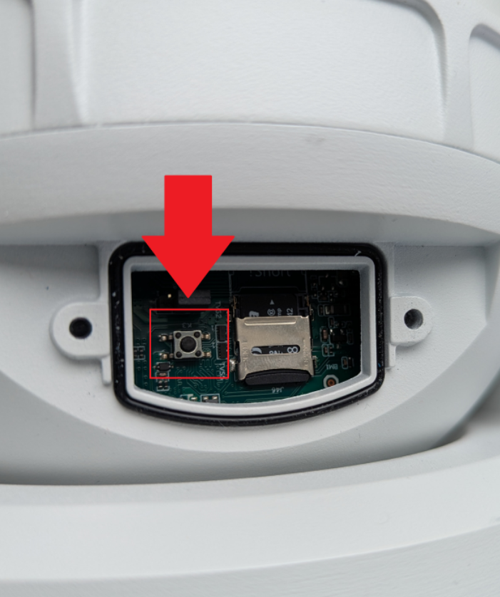

Step 1: Locate the reset hatch on the camera, remove the cover using a Phillips head screwdriver, and locate the factory reset button.
Step 2: Press the factory reset button for 30 - 45 seconds allowing the camera to reset. Once the reset of the camera is complete, place the reset hatch back  and secure it to the camera.
The camera has now been factory reset and reverted back to its original factory settings. This includes usernames, passwords and other settings. The default username and password is admin.
