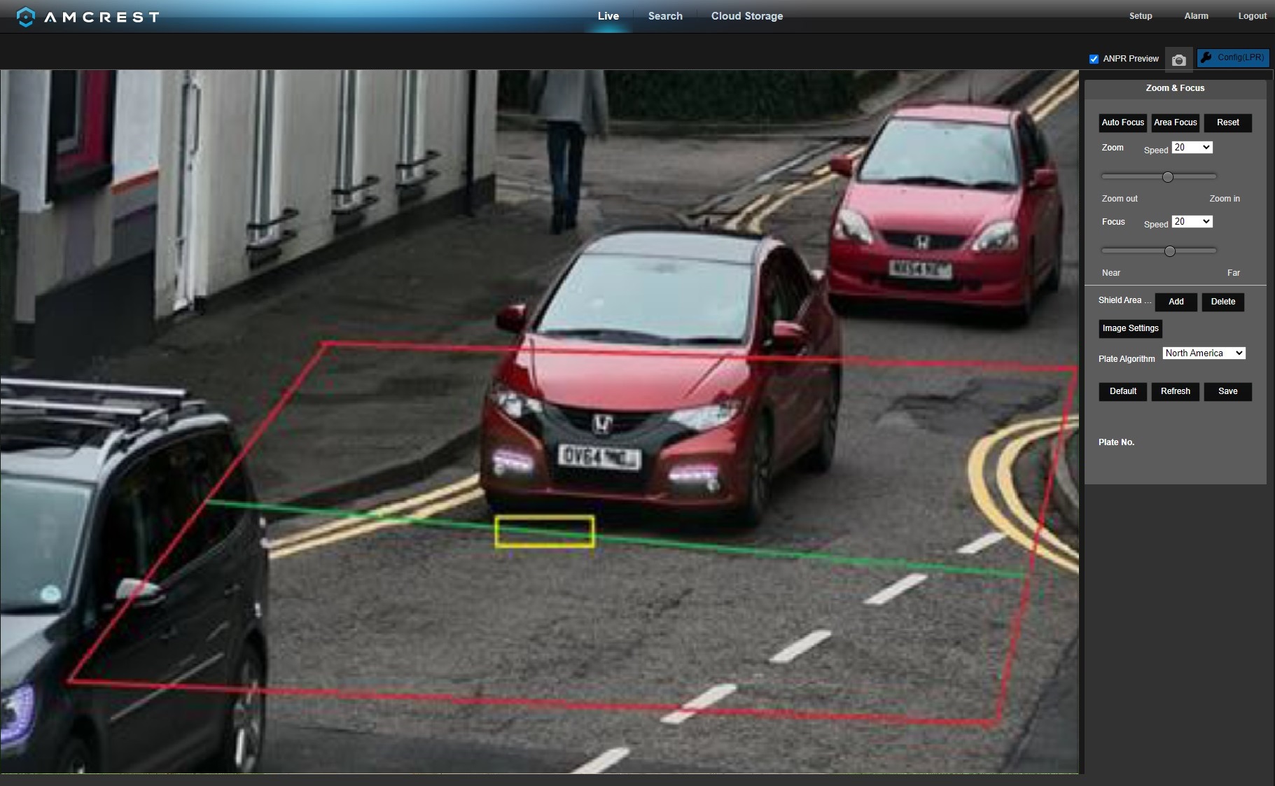

Step 2: Click the ConfigLPR option to begin configuring the detection area.
Step 3: It is recommended to adjust the lens so that the width of the plate number is close to 150 pixels. The capture area itself should be no larger than 2/3 the size of the feed.
Note: The plates should be visible in both daytime and nighttime conditions.

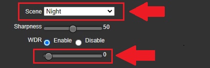

The image quality for WDR (wide dynamic range) can be set to 0 if needed. The WDR settings can be adjusted in the image menu by navigating to Setup>>Camera>>Image and set the WDR slider to 0 in the nighttime profile (scene) option. Adjust any additional light parameters if needed.

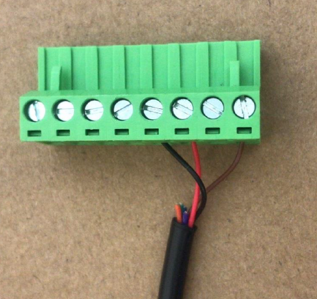

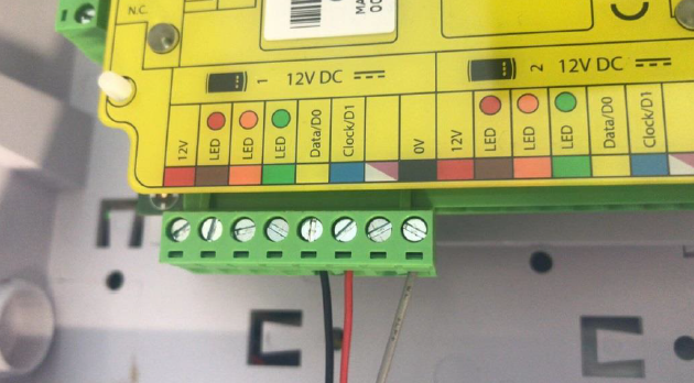

Step 4: Connect the camera to the Net2 Plus Reader port using a Beldon reader cable (as per Paxton specification).
Red wire: D1 at ANPR –Clock/D1 on Net2 Plus Reader Port
Black wire: D0 at ANPR –Clock/D0 on Net2 Plus Reader Port
Brown wire: GND at ANPR –0V on Net2 Plus Reader Port

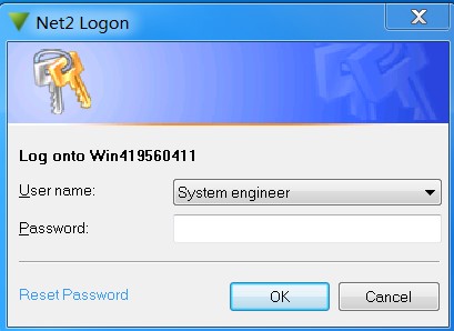

Step 5: Log into your Net2 Access Control

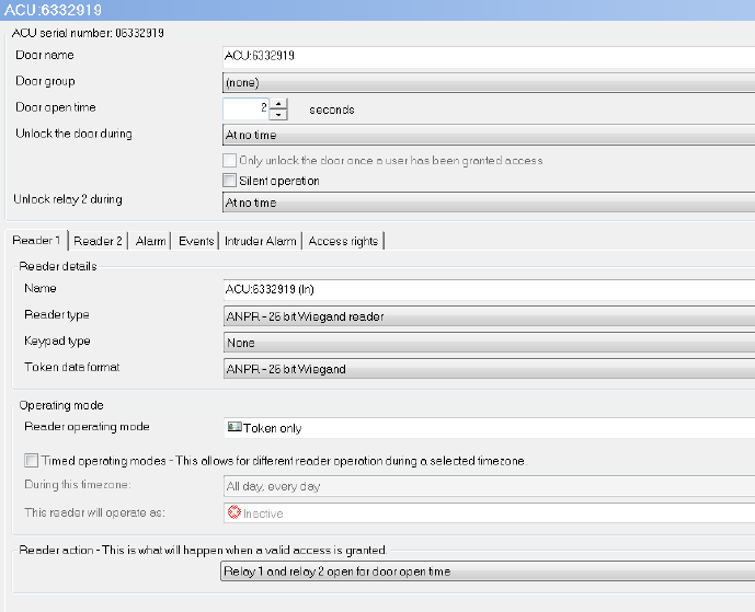

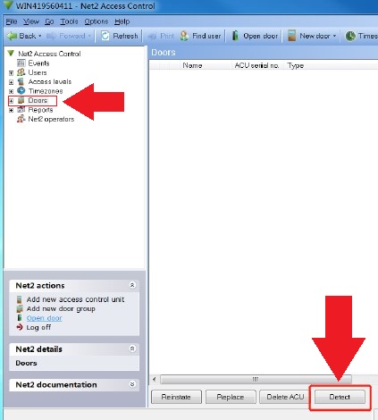

Step 6: Click the Doors option and click Detect to detect the door reader of the Net2 Plus software.
Note: If the Detect option does not work, you can try the Net2 Configuration Utility tool to detect the Net2 Plus.
The door settings for the ACU should be set for ANPR (license plate reader) devices.

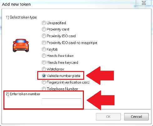

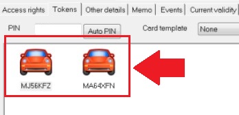

Step 7: Add a new user and select Tokens>>New Token to open the Add new token window. Select the Vehicle number plate option, enter the license plate number that belongs to the user and click OK.
The plate number entered will be displayed in the interface. Click Apply to complete the setup.

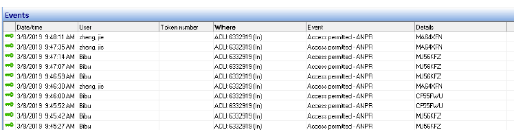

Once the camera detects the license plate number of the entered plate it will send the converted token number to the Net2 Plus and if the token is correct the controller will open the door. Logs of the event can be viewed in the Net2 Plus interface.
