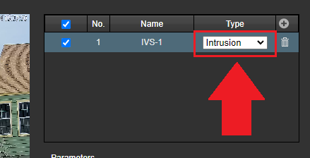

Step 2: In the web UI, click on Setup>>Event>>IVS. Click on the ( + ) icon to add the rule.

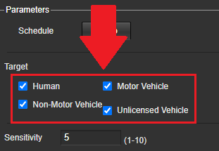

An optional object filter can be set that will allow the rule only to be triggered if it detect certain objects such as a humans, vehicles, non-motor vehicles, or unlicensed vehicles.

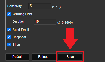

Note: Optional active deterrents such as a siren and red/blue LEDs can be enabled that activate once the rule is triggered by enabling the Warning Light and Siren option. Email notifications can be set as well that will send a snapshot of the event to your email by enabling Send Email and Snapshot options. Click Save.

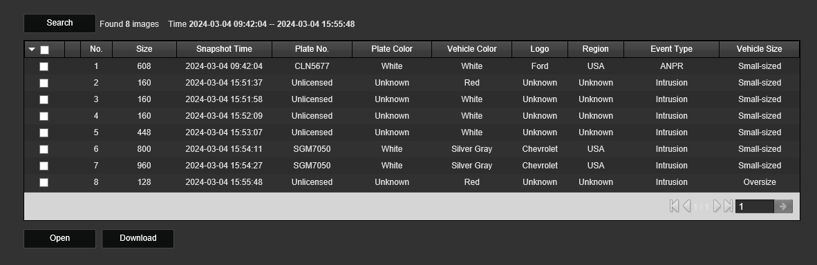

IVS events can be viewed on live view menu in real time or using the Search option. To view events in the search menu, click Search and in the Image Search menu, select the event, click open or download to view or download the event.
