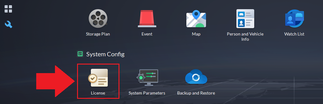

Step 1: Log into your Amcrest Orion software and select the configuration icon and select License.

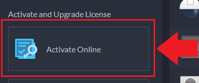

Step 2: Click Activate Online to activate your activation code.
Enter the activation code into the interface and click Activate Now to apply the license to the software.
Note: If additional activation codes are needed, click the "+" icon to add multiple activation codes.
