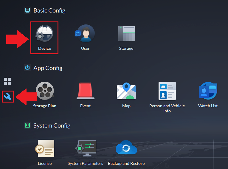

Step 1: Access the client software and select the configuration icon. Select Device.

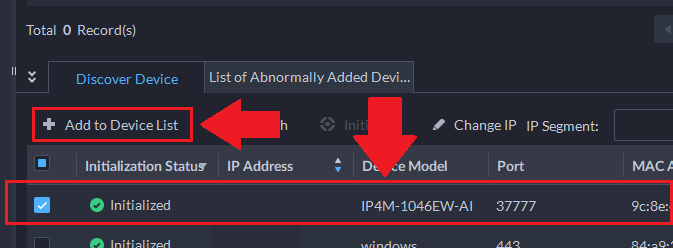

Step 2: All connected devices should be displayed in the Discover Device menu, however, click the Refresh button to refresh the interface if needed.  Select the device and click Add to Device List.

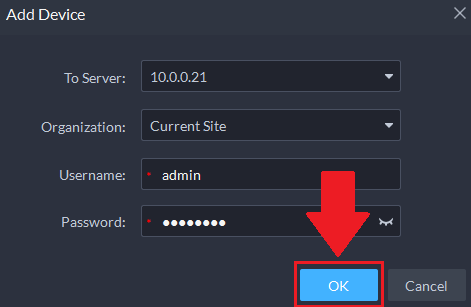

Step 3: Enter the password for the device and click OK.

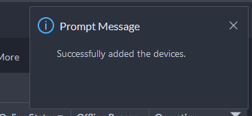

The device will be added successfully.
