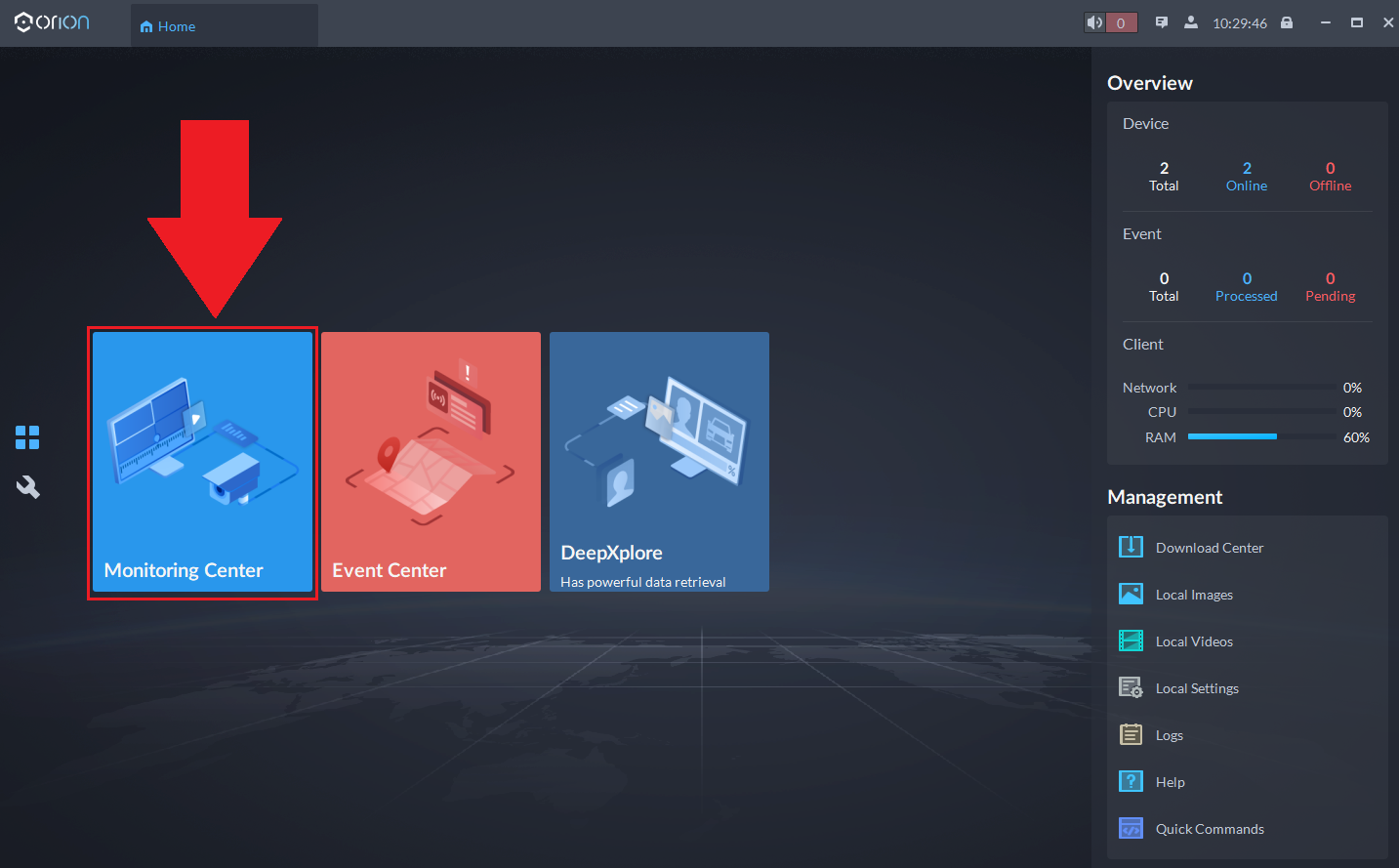

Step 1: Log into the Amcrest Orion Software and select Monitoring Center.

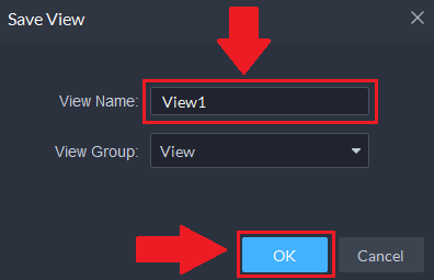

Step 2: Select each device from the device list and click the save icon ( ). Enter a name for the View and click OK.

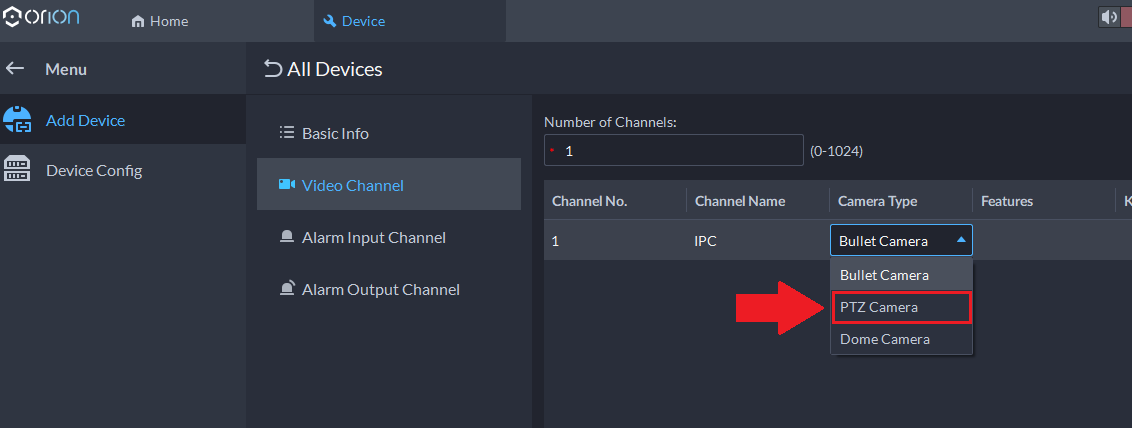

When you have finished creating the view you can now start configuring a tour. A tour will allow the software to shift between multiple PTZ presets set by the user in the software. If using a PTZ camera, please navigate to Add Device menu and select the edit icon ( ) for the device. Select Video Channel  and ensure the Camera Type is set to PTZ Camera. Click OK.

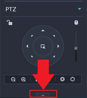

Step 1: Access the Monitoring Center, select the device, access the PTZ menu, and select the down arrow.

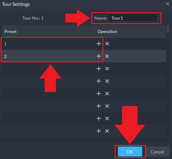

Step 4: Enter a name for the tour and click the add ( ) icon. Select all applicable presets related to the tour and click OK.
Note: Click the play ( ) icon to run the tour.

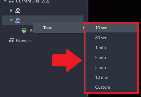

Step 5: Navigate to the Resources menu, right click on the device to set a tour duration.
Note: To stop the tour, click on the stop ( ) icon in the Tour ( )menu.
