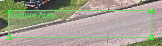

Step 1: Click the Config(LPR) icon. You will notice a capture area box, license plate data will be captured in this area of the interface. The capture area is set by default to the recommended area, however, can be adjusted by selecting the area with your mouse and adjusting the four corners of the box.
Step 2: Use the zoom and focus options if necessary according to the area that is being monitored.
Step 3: If there are areas of the capture area that need to be excluded, click the Add option located in the Shield Area field. Use your mouse to set a shield area in the capture area overlay.
Step 4: Click Save to apply the capture settings to the device.
