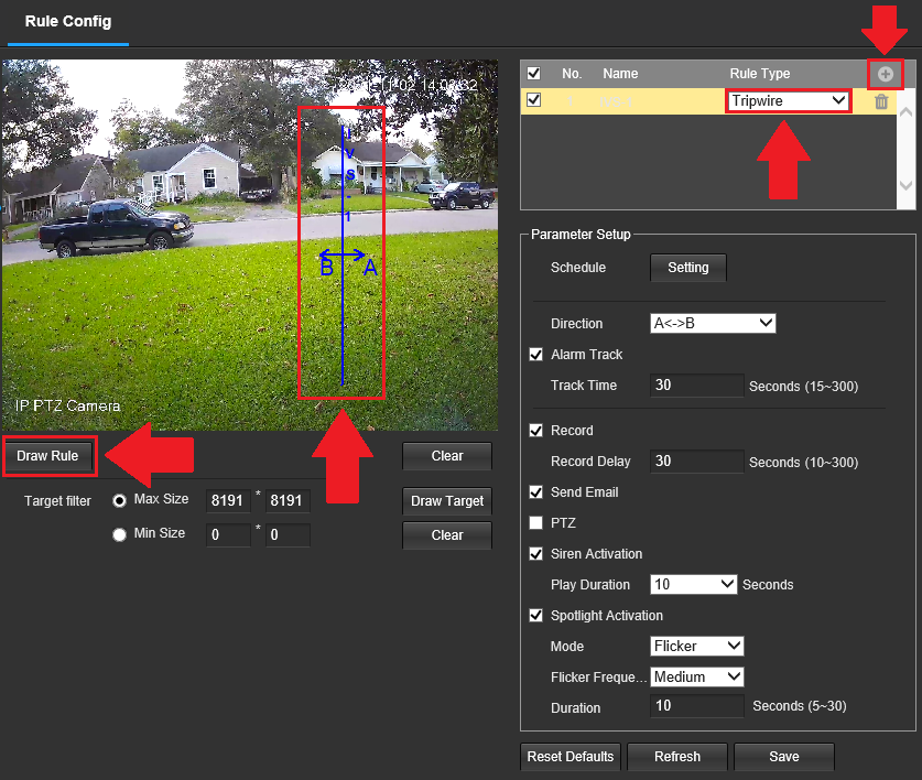

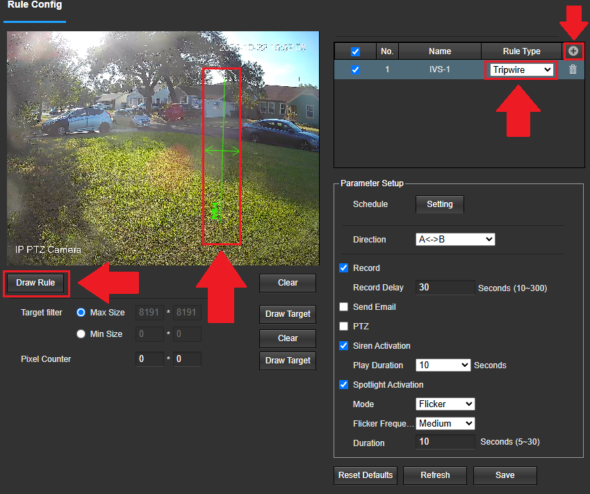

Tripwire allows the camera to trigger an event if an object crosses a set tripwire line. For more information on how to set up a tripwire rule, please refer to the information provided below.
Setting Up a Tripwire Rule

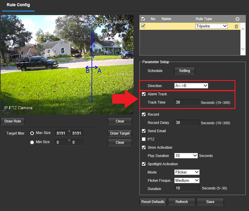

Step 4: In the Direction menu, choose which direction the object will be going for the tripwire to be triggered.

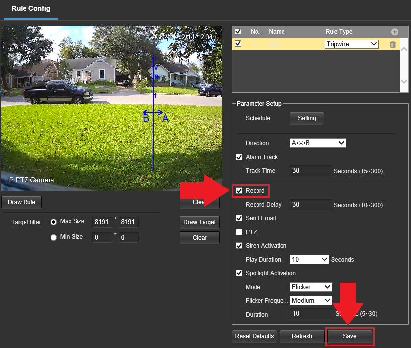

Step 6: If not enabled already, enable the Record checkbox to record the event. Click Save when done.
If you would like the siren and the spotlight option to be activated when the rule is triggered enable the Siren Activation and the Spotlight Activation options.

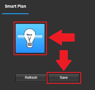

The tripwire rule has now been properly set up for your camera. The target filtering can be used to refine the set rule however for an optimal experience it is highly recommended to leave these settings as default. All IVS data can be viewed in the Playback menu if a microSD card has been installed, emailed.
