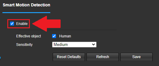

Step 2: Click on Setup>>Event>>Smart Motion Detection and click Enable.

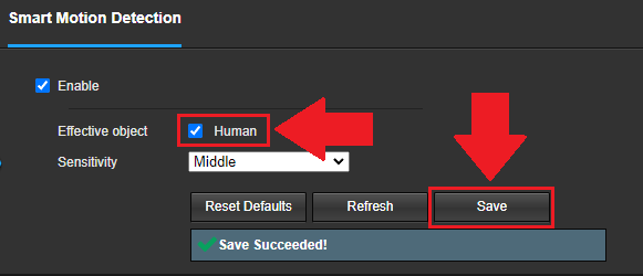

Step 3: Use the effective object filter (Human) to allow the device to detect only humans. Click Save.
Note: If you would like a snapshot of the event emailed to you once it has been detected by the camera, return to the video detection menu and click the Send Email checkbox. Please make sure email setup is established in the camera before enabling the send email option. For more information on how to set up email notifications, click here.
