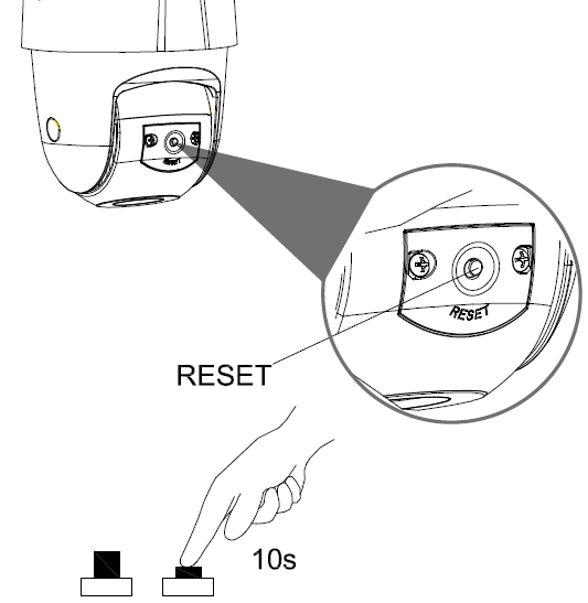

A factory reset will revert the camera back to its original factory settings. Please note, this will erase all settings applied in the camera that has been previously customized by the user. This includes all passwords or other critical login information. To proceed with the factory reset procedure of this camera, please follow the steps below.
Note: The device must be powered on to perform the factory reset procedure.
To factory reset the camera, locate the reset button on the camera. Press and hold the reset button for 10 seconds and release. Allow the camera to reset and initialize.
