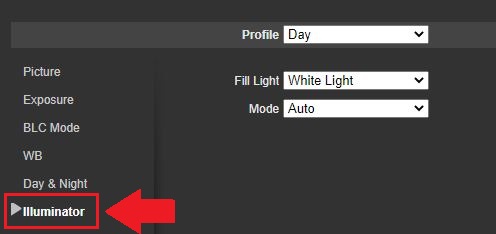

Step 2: Navigate to Setup>>Camera>>Configuration and open the Illuminator menu.
Step 3: In the Illuminator menu, click on the Fill Light dropdown menu and select IR Mode. This will change night vision from spotlight mode to IR mode.

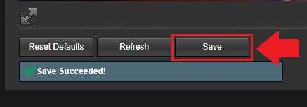

Step 4: Click Save.
