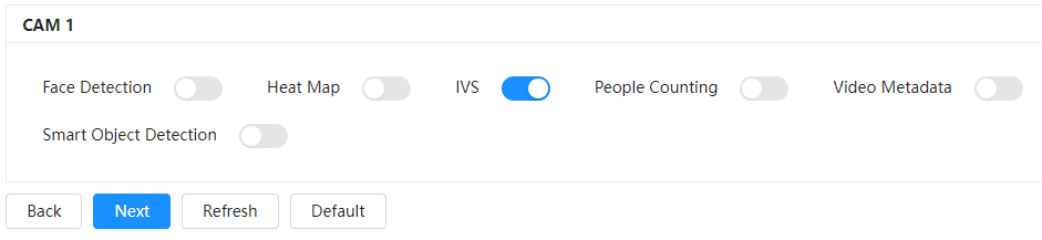

Step 2: Access the main menu and click on AI. Select a General or Schedule plan, if you would like more information on how different intelligence modes work on your camera, click here.
Step 3: Click Next. Select IVS from the Smart Plan menu and click Next.

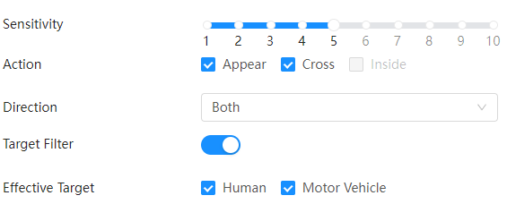

Step 4: Click Add Rule and select Intrusion from the dropdown menu. Use your mouse to draw a detection area on the interface.
Step 5: In the Action menu, set the rule to trigger if the object appears or crosses the detection area. An option effective target filter can be set that will allow the rule only to trigger when a human or vehicle crosses the area.
