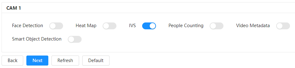

Step 3: Click Next. Select IVS from the Smart Plan menu and click Next.
