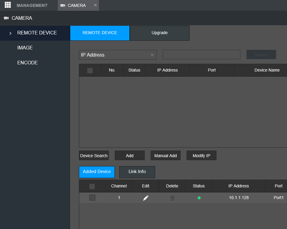

     2. Access the NVR's main menu and go to, Camera in the Management section. In this menu click on the device Search option to search for your device on the network.
     3. Click the Device Search button, and you can view the searched IP addresses at the top pane of the interface. Double click an IP address or check one IP address and then click the Add button to add the current device to the bottom pane of the interface. The system supports batch adding.

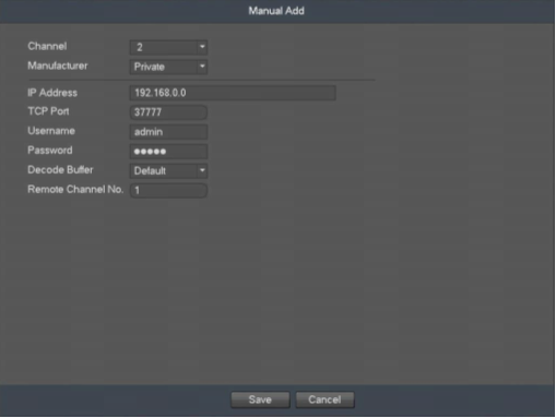

     4. Click the Manual Add button to add a device directly. Here you can set TCP/UPD/auto connection mode. The default setup is TCP.
Note: The manual add function is for Foscam, Dahua, Panasonic, Sony, Dynacolor, Samsung, AXIS, Arecont, ONVIF, and Custom. When the type is custom, you can input the URL address, user name, and password to connect to the network camera without selecting the network camera manufacturer. Please contact your network camera manufacturer for the URL address.

     2. Access the NVR's main menu and go to, Setting->Camera. In this menu click on the Device Search option to search for your device on the network.
