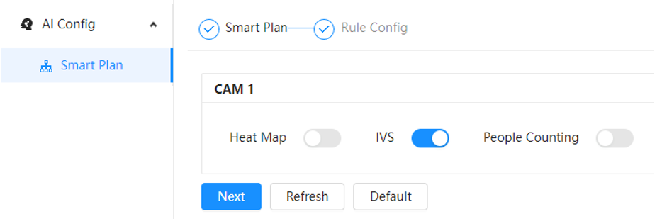

Step 2: Access the main menu and click on AI, select IVS, and click Next to continue.
