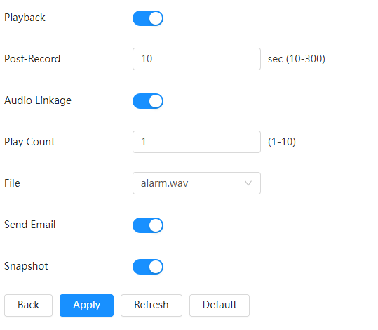

Step 4: Click Playback to retain events to a microSD card. This will allow you to view IVS events in the playback menu. Select any additional options, such as a audio linkage, which will allow the camera to produce an audible siren, or email to send a notification of the event to an entered email address. For more information on how to setup email alerts, click here. Click Apply when finished.
