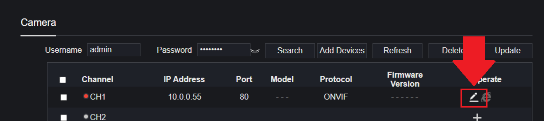

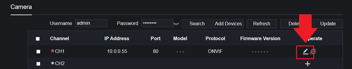

Once the ONVIF user profile has been created on the camera side navigate back to the NVR and open the Camera registration menu. If the status is still red, click on the modify icon in the Operate menu.

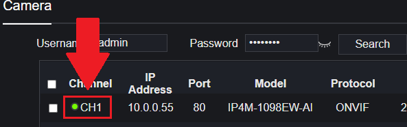

Enter the username and password for your device into the interface and click OK. Select your device in the device list and click Refresh, you will see the status of the camera turn green indicating it is successfully connected.

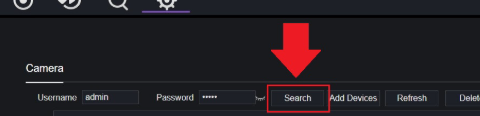

Step 2: Click on the Settings icon (gear wheel) and select Camera. Click Search.

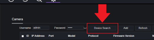

Step 3: Click Device Search.

Step 5: Click the modify icon in the Operate menu.

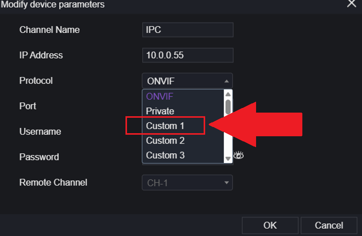

Step 6: Select the Protocol dropdown menu and select a custom protocol. Make sure the device's password is correct and click OK.

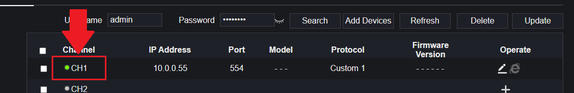

Step 7: Select the device and click Refresh. The status of the device will turn green when connected.
