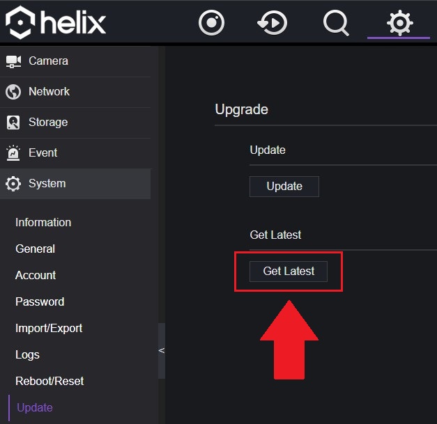

Step 2: Click the Settings icon and select System and click Get Latest, This will take you to a firmware downloads website. Be sure to subscribe to access the firmware downloads page for your device. Locate and download the firmware file for your model and save it to your computer.
Step 3: Return to the Update menu and select Update. Locate the firmware file that was downloaded on your computer and click Open. Allow the device to upgrade.
